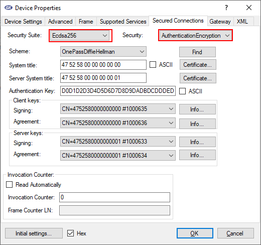

When you have correct certificates imported for the GXDLMSDirector you can create a secured connection to the meter. You can create a new meter or use the old one. You need to select "Secured Connections" tab from the device properties.
Then change used security suite to 256 or 384. Used security suite you can see from the Security setup as described in Is my meter supporting public and private keys.
Next you need to change security level. Usually it's AuthenticationEnryption, but this depends from your meter. Next change used schme. You need to select between One-Pass Diffie-Hellman and Static Unified Model.
Difference of those schemes is well documented in NIST documents and I'll don't cover it here.
Set client and meter (server) system title. You can get the meter and client system title from the certificate. Then press "Find"-button. It will update the correct certificates automatically and you don't need to find them.
Note! It's common mistake that some else is updating the new certificate for the server and after that communication is not working. It's good to always compare certificate serial numbers if communication is not working with encrypted communication.
You can get more information from the certificate by pressing "Info..." button.

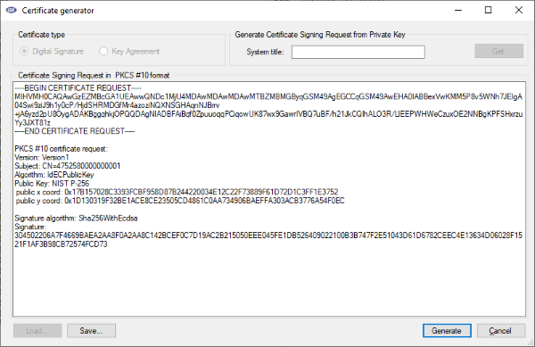

You can't add generated private keys to the meter. You need to ask meter to generate the private keys. This is done by selecting "Certificates tab from the "Security setup" object. Then press "Key pair...". It will generate a new private key for the meter.
Certificate generator
Next you need to generate a new certificate request. Certificate request is sent to the Gurux Certificate Generator service and a new x509 certificate is generated. Save x509 certificate to the file.
After you have x509 certificate you need to import that to the meter. Press "Import certificate" and select generated certificate. Certificate is now send to the meter and you should see it there when you read certificates again.
